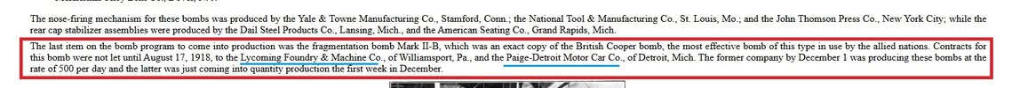

Investigating further, it appears that although the US produced an exact copy of the British Cooper's Bomb - referred to as the Fragmentation Bomb Mark II-B, the US manufacturers (aka Paige-Detroit Motor Car Co / Lycoming Foundry) were not equipped to cut the British (Whitworth) 55-degree rounded thread profile and instead re-tapped the fuse /mechanical junctions using the standard US 60-degree V-threads.
References:
1) America's Munitions 1917-1918
2) Google Research:
3) It can be assumed from the above that the US did not produced 20ib Cooper's bombs for Britain under licence.
My current opinion is that the example shown is a British made No16 Nose pistol (has a Whitworth 16G thread) or a conversion from a No7 (Whitworth 14G) to fulfill late war operational demands for the 20lb Cooper's Bomb. Eitherway an interesting example indeed.
