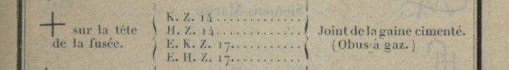

For reference

So i clarified my documents with more attentivnes , and wread paper of Mr Belot.
The k gr 15 grkz was replaced as the 7.7 mm long H.e was introduced , and in upcoming short period of time chemical long shell was introduced. Maybe simultaniously (idk)
(Long H.e mentioned in inter front messages from July 1916 ).
So in conclusion , the topics green cross Kz 14 could have belonged to either one of the shells , because long chemical also had Kz 14 with magnesia and the cross stamp.
But im not sure for how long the fully brass fuzes where used. Im just assuming by subjective experience on the fields.
If You dear members have something to add , i would be glad to get a new knowledge.
If any require proper photos of the fuze (propper background) send personal message.
