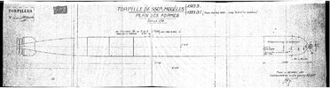

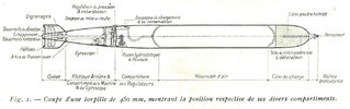

Hello everyone, I'm searching for plans of the torpedoes, mines and depth charges used by the french navy during the first part of the war (1939-1940).
I've already find some but if it's possible I'd like to have the others.
(I also have the manuel du marin torpilleur)
Does anyone have any plan ?
Thank you for your help.
