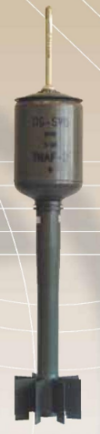

Talk about a long search! I had this fuse in my collection.
Hi Fusse2004
From that drawing, the logical questions are: what kind of bomb (group of bombs) is it, what kind of fuse (specific type), what kind of fuse release group is it and why and for what types of aircraft and thus era is it?
Does the system have a designation and manufacturer?
I will just note that notice the inclination of the release mechanism to the longitudinal axis of the fuse ..... if you look at the APUV type for example, that inclination is not required there.
Hello! I only have this drawing, too! I got the part in question from a Czech person years ago. I don't have any other information about it. Unfortunately, I can't answer your questions.
